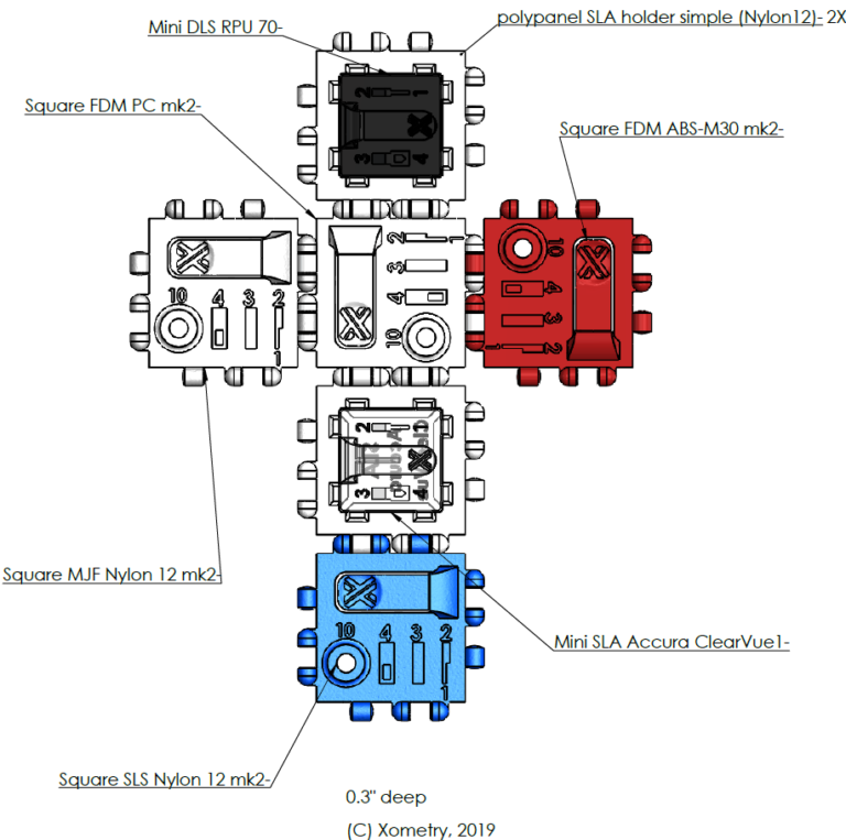

This is why Xometry has created a 3D Printing Sample Cube that shows off some of the most popular 3D printed polymers and 5 unique additive manufacturing processes. The cube consists of polypanel-compatible squares that can connect together to form a cube, as well as easily separate. We designed these for future expansion packs (coming soon!) to grow your material collection over time.
Xometry’s 3D Printed Sample Cube offers six different materials and 5 different processes for comparison. Note that the flexibility differs between features and each material has its limit. Tabs and hinge features can break with excessive force.

Watch our video showing the components below:
A Closer Look at the 3D Printing Sample Cube
Here’s what the 3D Printing Comparison Cube comes with:
